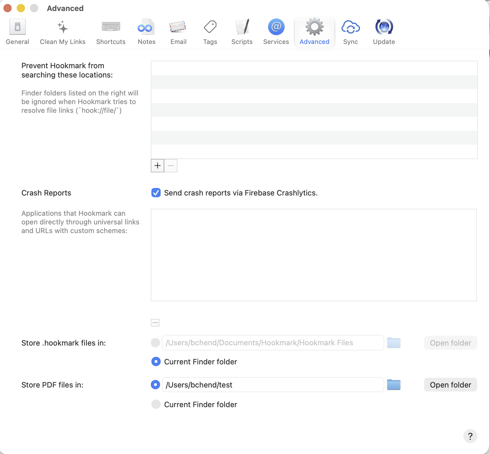

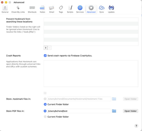

@AutonomyGaps , I am not sure this will help.
Currently, you can configure .hookmark files location in Hookmark Preferences window->Advanced->Store .hookmark files in: ->Current Finder folder.
Thanks for pointing this out! It does make it much easier.
