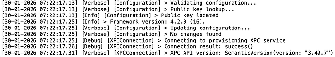

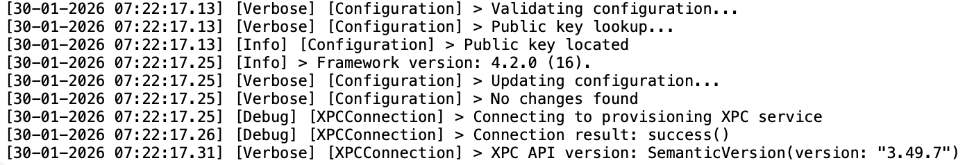

Thanks for your reply @bchend -
That log though seems to just be for the app itself. It doesn’t seem to capture any script interactions (success or error).
I’d assume that Hookmark does something when an x-error is returned (i.e. via hook://x-callback-url/link-to-new-error). Where would i find these?
