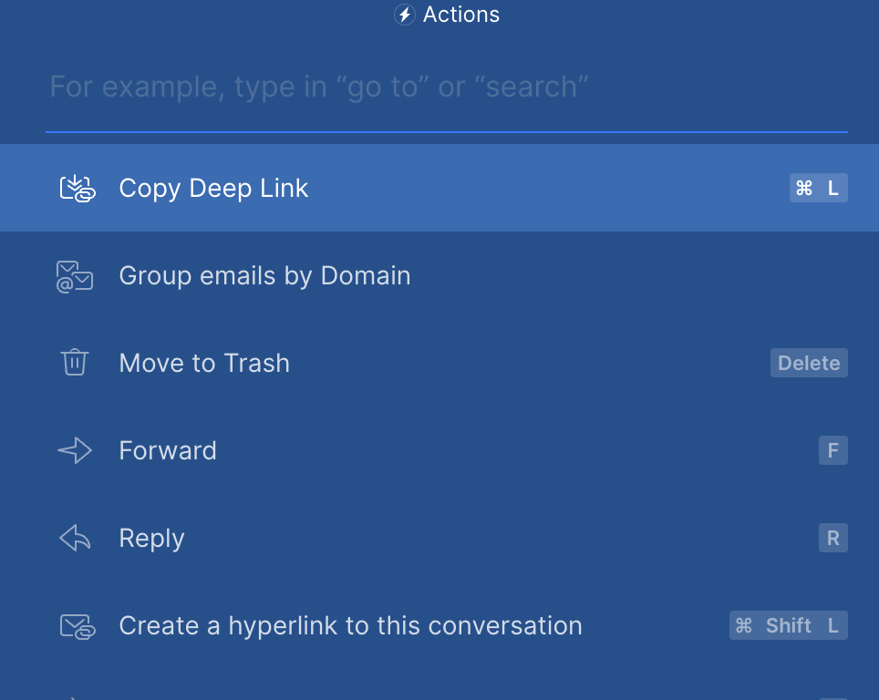

Hookmark uses command+L to get the email deep link. Does command+L copy the deep link on your mac?
I think the issue may be that I use the Setapp version, and Hookmark might not recognise it?

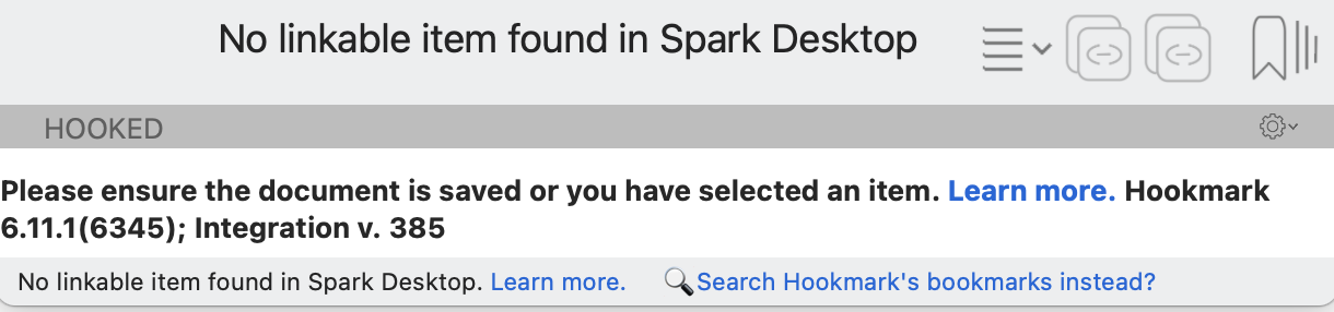

Could you please post the screenshot of Hookmark window?
Hi, thanks for your reply. Please see the screenshot below.

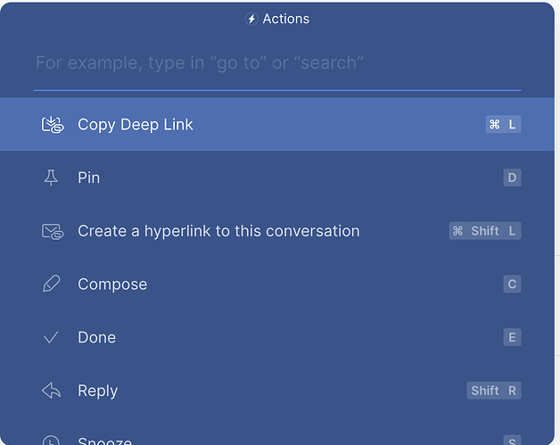

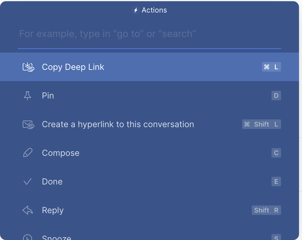

Hookmark uses the shortcut command+”L” to get the email deeplink. If you press command+l in a Spark email, what do you get? You can check if the shortcut for Copy Deep Link is command+L.
Hi. I have the default key bindings, and I see the CMD+L link when invoking through CMD+K. When I manually press CMD+L, it copies the link just fine

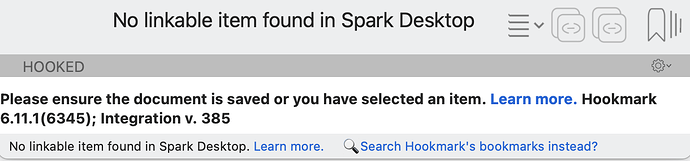

hi, I followed your instructions (and hit “Save” for the updated scripts code), but the latest code you supplied does not work with Spark Desktop. Smae error as before
Thank you, @mountain .
Is there a dialog box before you see the “No linkable item…” window? Is your Spark Desktop from Setapp?
Hi, the spark desktop app is from the App Store, not setapp. There’s no dialog box that appears. However, I see that the code you sent me is not the same as the code you had sent me previously which I had confirmed to work when running from script editor; did you intend to ask me to insert the code that worked into the app but instead gave me a non-working version of the code instead?
