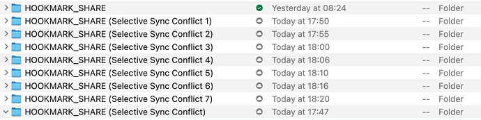

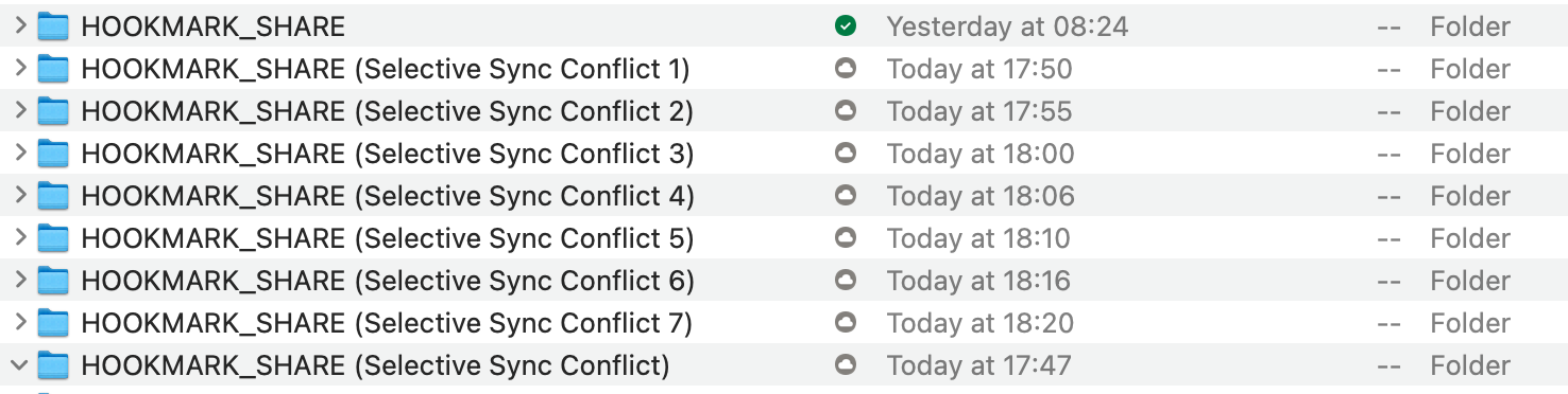

Attached a screenshot of the folders that are created every +/- 3 minutes. I came to delete the old folders.

The folders are situated in Dropbox. I have only one shared folder.

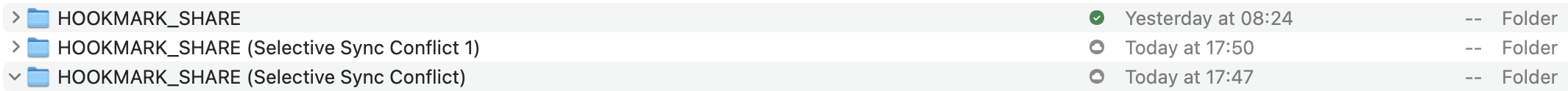

An update after a few minutes.

Are there any files in HOOKMARK_SHARE folder and those conflict ones? If this is the folder for sync, could you please turn off sync and see if there is any difference?
Also could you please check the read/write permission of HOOKMARK_SHARE folder?

Thank you, @Jomoens .
It seems Hookmark can’t detect HOOKMARK_SHARE folder for some reason and tries to create the folder again.
Could you please
(1)quit Hookmark from all your macs,
(2)remove all conflict files from you Dropbox account,
(3)rename the original HOOKMARK_SHARE to HOOKMARK_SHARE_OLD?
When you see those conflict files are not on your mac any more, HOOKMARK_SHARE folder is renamed, then start Hookmark and turn on sync again. See if it resolves the issue.
