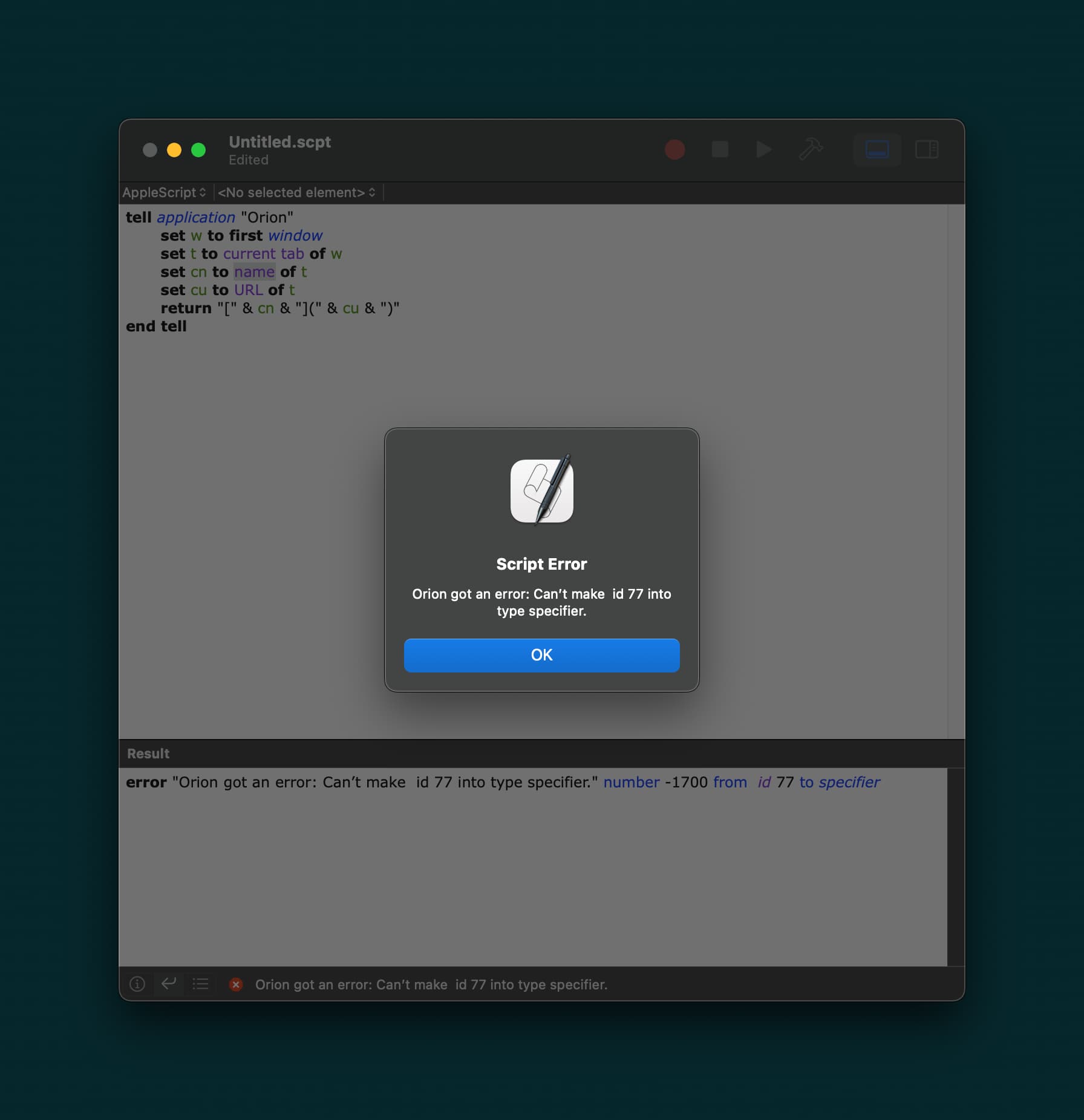

Hello,
Thanks for the reply. “Reset to default” was not enabled. When I run the script in the script editor, I get this result:

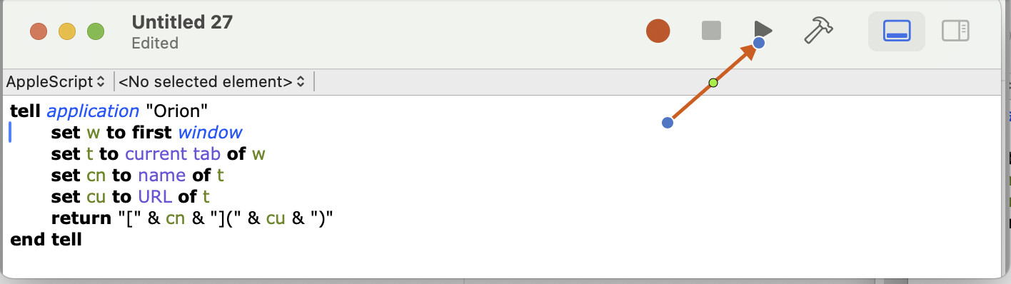

To anyone who winds up here because of a web search, I thought I would give some help.
It seems like get current tab of window would wind up saving an id to the variable.
I updated the AppleScript to the following, and it worked for me:
tell application "Orion"
	set cn to name of current tab of first window
	set cu to URL of current tab of first window
	return "[" & cn & "](" & cu & ")"
