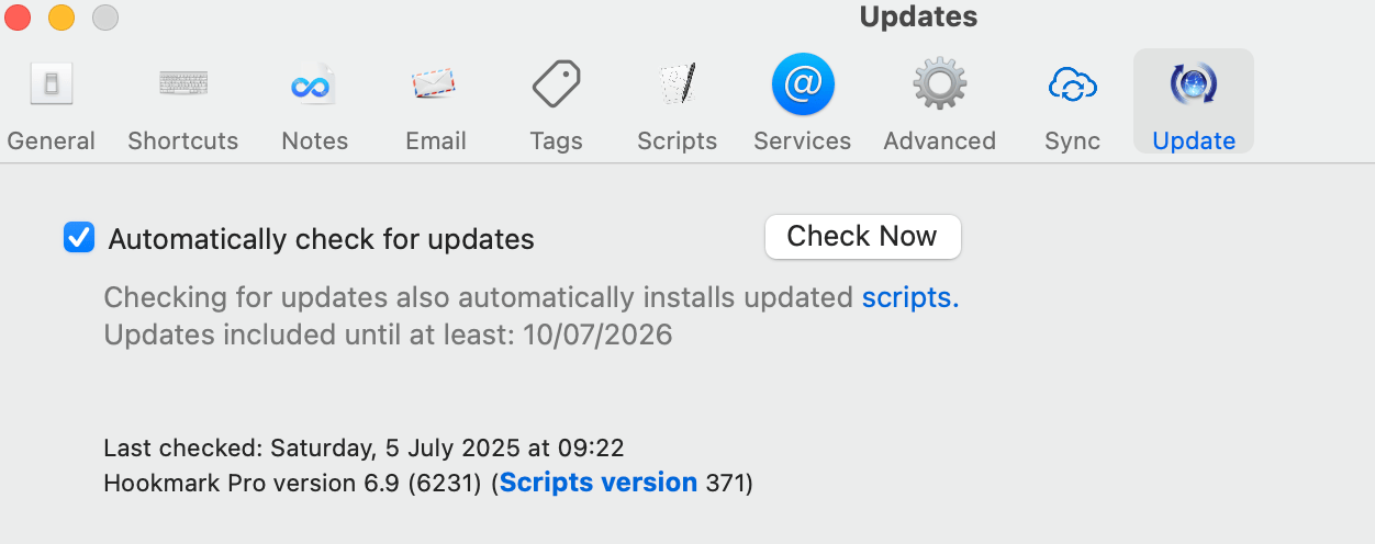

@Tech_in_IT , we have updated our script server, version 371. Could you please go to Hookmark Settings window ->Update->Check Now to update your script and see if it resolves the issue? You might need restart your Hookmark.
Just checked it now:
script version seems to be fine. I closed and reopened Hookmark and tried to create a hook in Scriverer but it doesn’t work, still no linkable item :frowning:

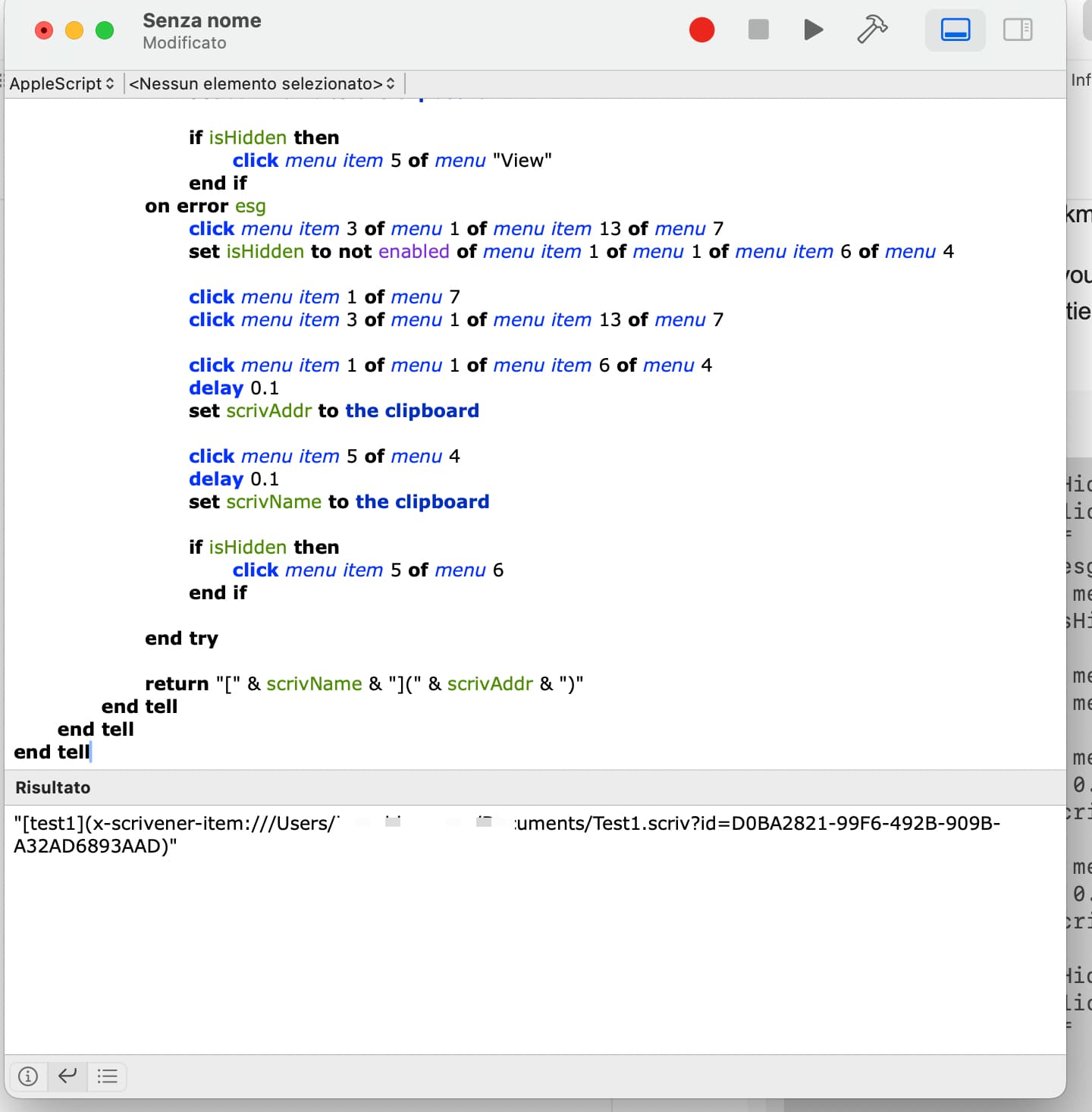

If it still does not work, could you please select an entry in Scrivener, copy the script below and Paste it into /Applications/Utilities/Script Editor, then click on run button. Please post the output of the result pane here.

Great, thank you so much, I just reverted the script (minus sign) and updated. Now it’s working fine :slight_smile:
Anyway, hoping this can help you or others, here’s the output of the script:
