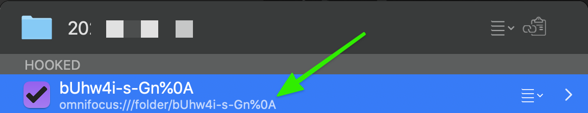

Everything seems to work fine at first glance, but when I tried opening the OF project from the Hook window after selecting the linked folder in Finder, it wouldn’t work.
Upon closer inspection, the link in Hook has a “%0A” appended to it. The original link from OmniFocus does not have that “%0A” text. I’m guessing it’s the line break that OmniFocus copies for some reason (a bug I guess on OF’s end?).
Raw OmniFocus link:
original url from OmniFocus
URL stored in Hook app:
Anyway, is there any way to remove this or fix it somehow on Hook’s end? Does anyone else run into this issue? If so, how have you dealt with it?

If you use OmniFocus itself to get a URL to that item, do you get %0A tacked onto the end? Oh, …, I see that you have a screenshot which is presumably using OmniFocus’s in app Copy Link?

Ah, I see what is happening.
You used OmniFocus to copy the link.
I must have used Hook’s Copy Link, or I was looking for an escape character that I didn’t see. Either way, I have replicated OmniFocus Copy as Link issue.
Hook avoids the OmniFocus bug because its “Get Address” script uses AppleScript and constructs the link itself, like this:
        if class of theSelection is folder then
            set theURI to "omnifocus:///folder/" & id of theSelection
        else
            set theURI to "omnifocus:///task/" & id of theSelection
So, Hook constructs the URL from the ID. We don’t ask for the URL, we construct it.
So the solution for you is to rely on Hook’s Copy Link not OmniFocus’s. So another advantage of Hook over Keyboard Maestro (UI scripted) style solutions for hyperlinking.
