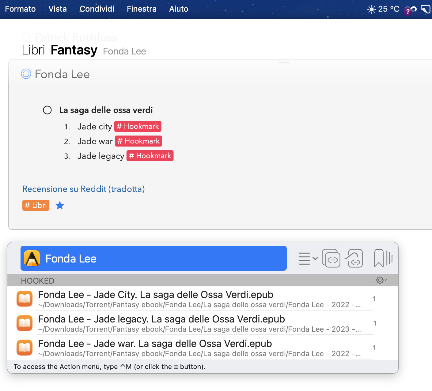

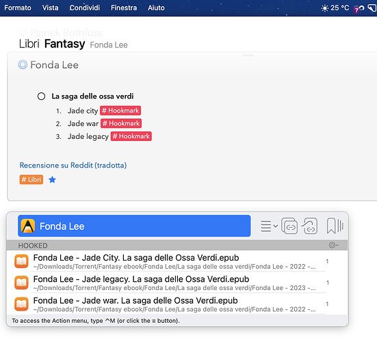

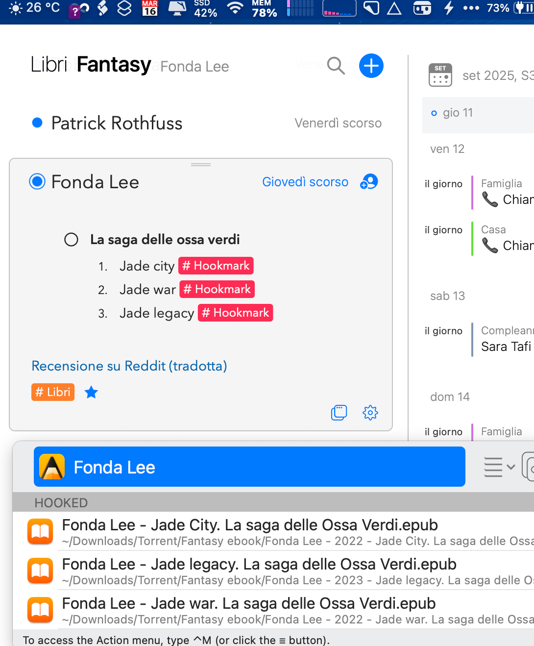

I am not sure it’s working properly:
This is Agenda app with a highlighted note. There are three ebooks hooked but Hookmark icon on the menubar shows a question mark.
Works for me, so I guess its just being buggy for you. One of the devs might have something to add.

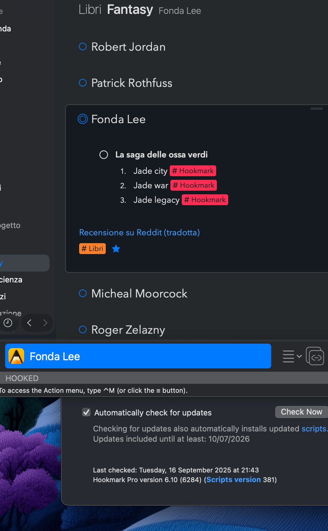

We have updated our script server, version 381. Could you please update your Hookmark script and see if the issue is fixed. (Hookmark preference window->Update->Check now)
You need restart Hookmark to see the change.

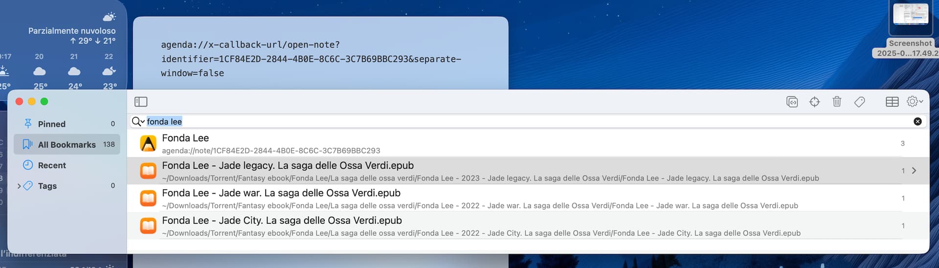

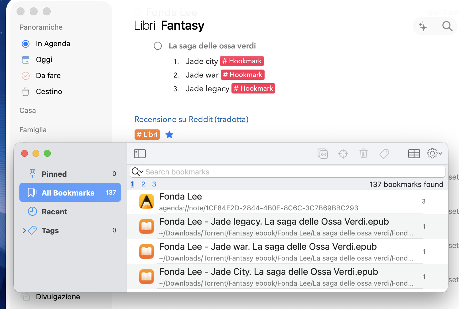

I have checked the number of bookmarks I have for that note and it is correct:
But if I click on the note (to highlight it) and hit control H, nothing is shown.

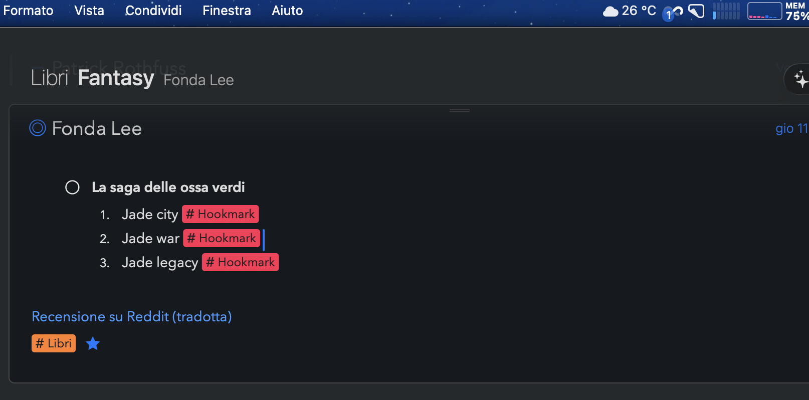

Ice works a little better and, after a reboot, is now able to show Hookmark and other apps in the menu bar. When nothing is selected the icon shows a question mark but if I open Agenda and select a note which has hooks, the plain icon is shown with no count (it’s enabled in the settings, of course).

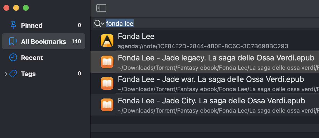

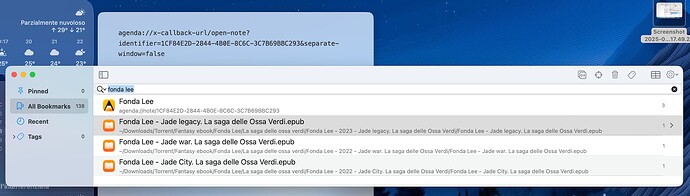

Could you please select Fonda Lee bookmark in Bookmarks window, do CTRL+H and see if you can see the links?
Then select Fonda Lee note in Agenda, do CTRL+H, do Copy Link and compare the url with the one in the library window? Are they the same?
Yes, they look the same but on the “control H on the note” output there is a sort of suffix:
“&separate-window=false”
The URL returned from AppleScript contains this, but x-callback-url does not .

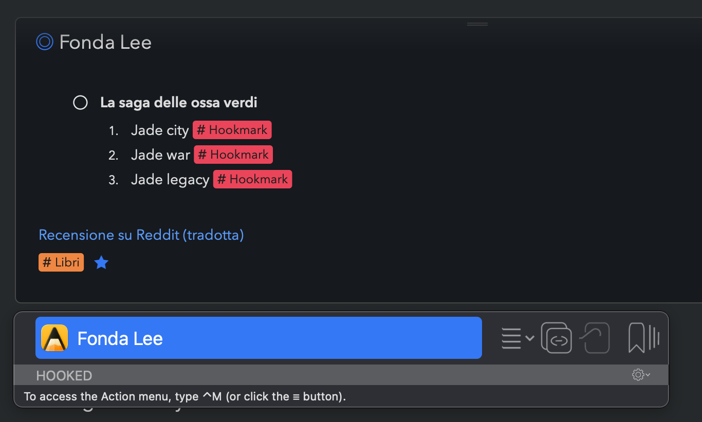

hmmm, no change unfortunately:

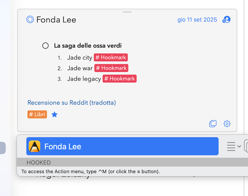

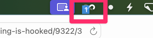

But I have added another hook (well, a new one) and now the icon works fine:
and in bookmarks I can see:
So, the new hook either overwrote the old one or was just ignored as another one (identical) was present. Basically, given the menubar counter is working (will do further testing tomorrow), it seems that Hookmark on Tahoe (and on my Mac) can’t retrieve the hooks I have recorded before the upgrade.

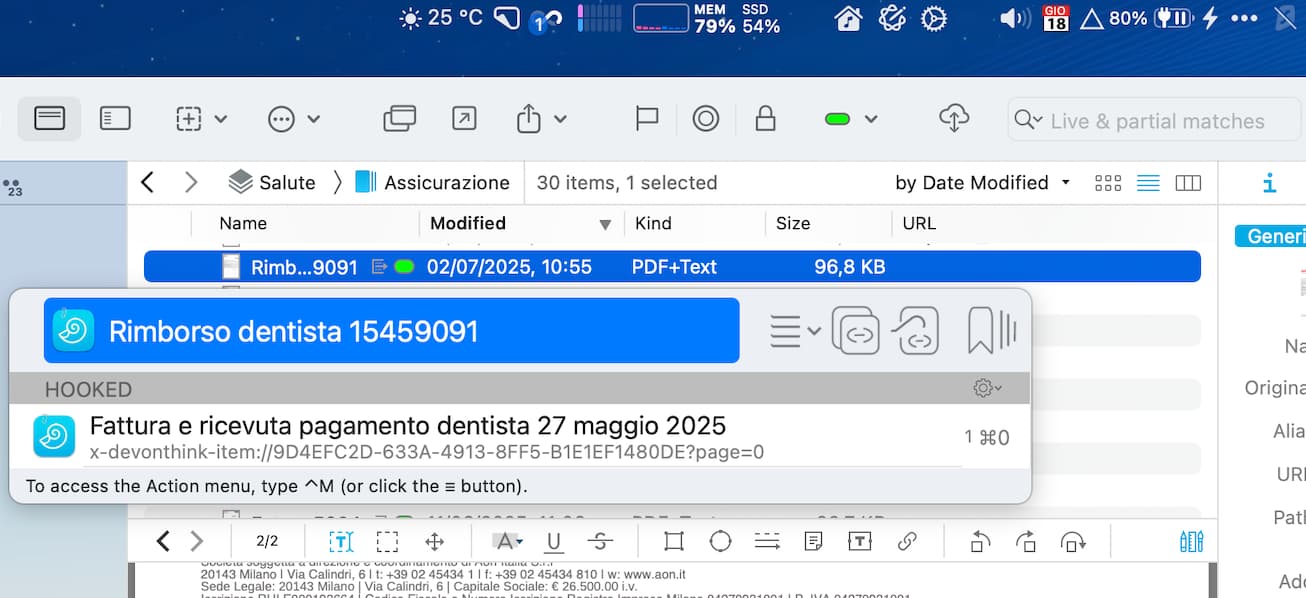

I am not sure this can help (don’t think so but you never know…), in Devonthink the counter works perfectly:
