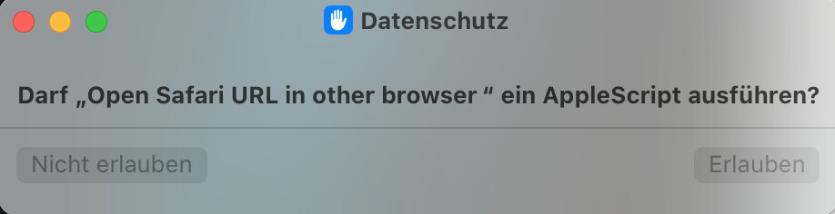

After searching the web like a madman and trying all maintenance procedures that came to mind I more or less accidentally found that Hookmark’s badge interferes with Shortcuts security dialog (under OS 15.7.7 and most likely other OS versions and other Shortcuts dialogs, too [untested] ).

• A security dialog comes up with two buttons, both greyed out and therefore not clickable. All you can do is click the dialog’s close dot to close the dialog. The macro then gets aborted.

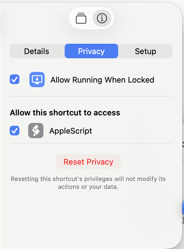

(If no security dialog comes up, open the shortcut’s security tab and click the button at the bottom saying something like “Reset security settings”.)
• Execute it again and drag the dialog across the screen. You will observe that both buttons will be enabled for splits of seconds only to return to their disabled states when dragging stops. Obviously the Badge is competing with the dialog about being frontmost.

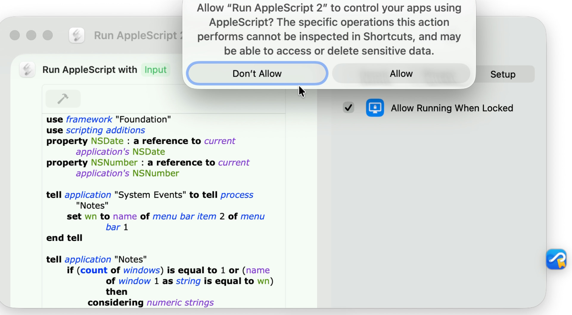

Just want to make sure I didn’t misunderstand. Here is the dialogue box I saw when I clicked on the run button.

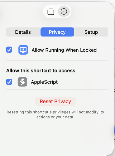

After granting authorization, you can click the “Reset Privacy” button to make the dialog window appear again.

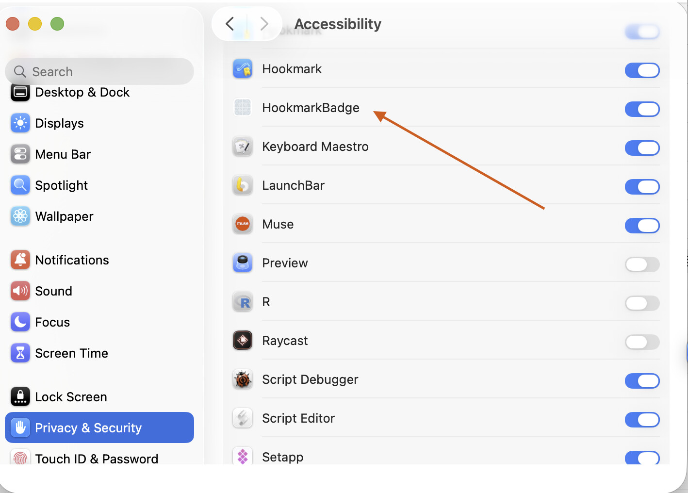

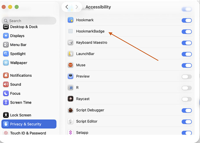

Could you please enable Accessibility permissions for Hookmark badge and see if it make any difference? Hookmark badge is inside of Hookmark.app. You can find it by searching Hookmarkbadge in Finder.
OK - judging from your dialog screen shot both buttons are NOT disabled - so this seems to have changed in Tahoe, I suppose. In my case, Sequoia, both buttons are disabled and not clickable, so I can’t grant authorization, at least not while the Badge is showing. When I drag the open dialog (wildly) around I see both buttons become enabled only for splits of seconds several times and when I stop dragging around both end up as disabled again. This is clearly from the OS messaging going on behind the sceens where the dialog is declaring to be frontmost (as it should be, also in relation to the badge), a notification the Badge receives and decides to make itself frontmost in turn, over and over again.
Just found out: if I disable the Badge while the security dialog is acutally open, the buttons become clickable as soon as the Badge vanishes from screen. Which I would call expected behavior, given my analysis above.
And no, this has got nothing to do with Accessibility, it seems. Settings were turned on as they should be. Turned them off and and on again, no change. I didn’t expect any.

I installed Sequoia on a MacBook. Running the shortcut with AppleScript seems to be working fine. I am not sure that makes the difference.
