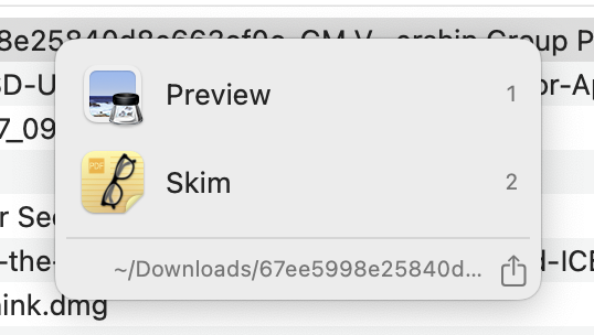

I use OpenIn (link) which gives you a pop up menu when you open a PDF. Then you click on which you want, or press 1, 2, 3, etc to choose the app you want.
Alternatively you can make it use a specific app by opening the file while holding down shift, cmd or option.
You can also set it up with rules, like always using a certain option when opened in a particular app, or when opened from a certain path on the file system.
Its free with SetApp or costs £12 as a one off. Its main task is actually to handle opening links in different browsers, but since it works with suffixes as well as prefixes, it’ll work with any file typ. I also like using it with MD files so I can switch between editing and previewing MD files in different apps.
