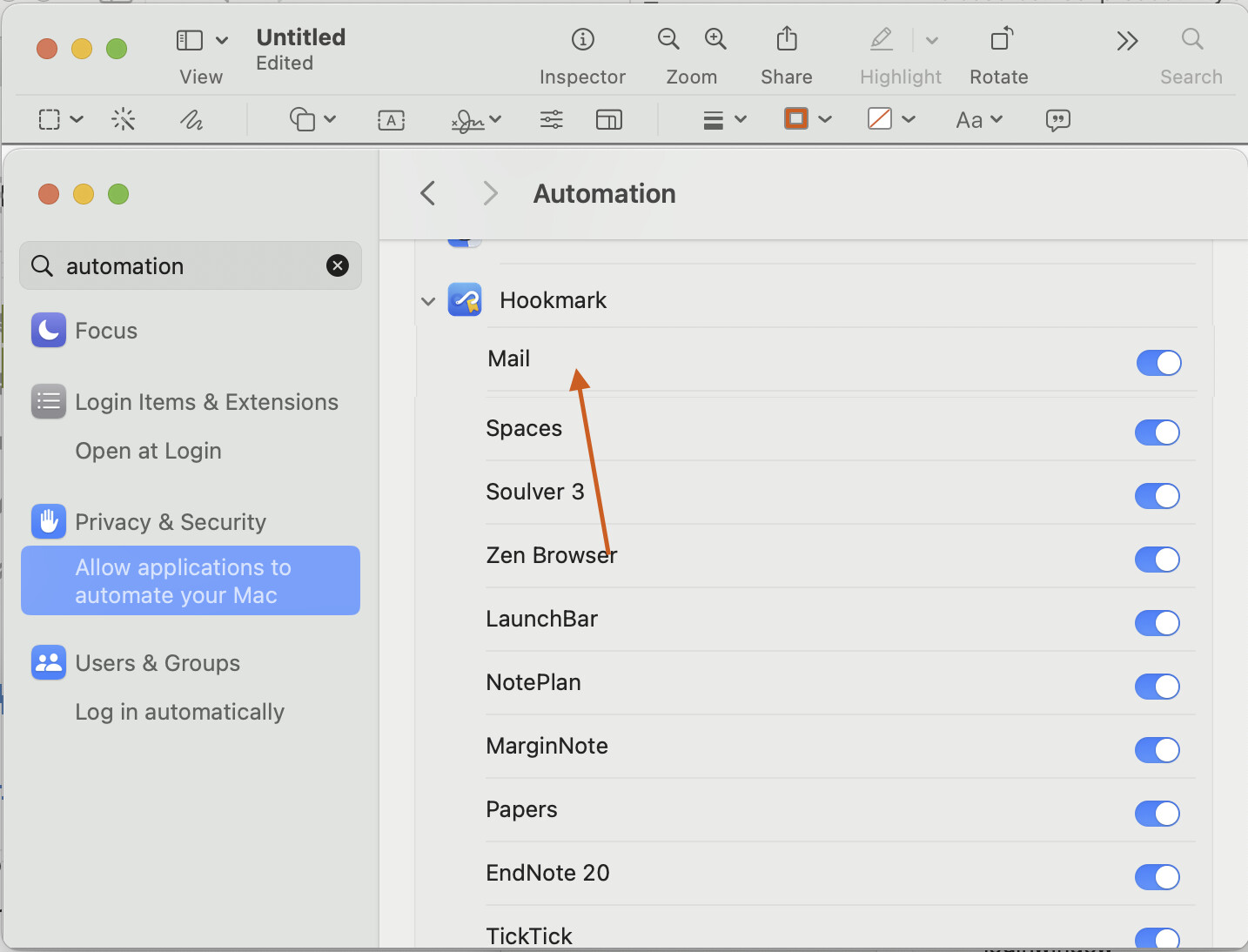

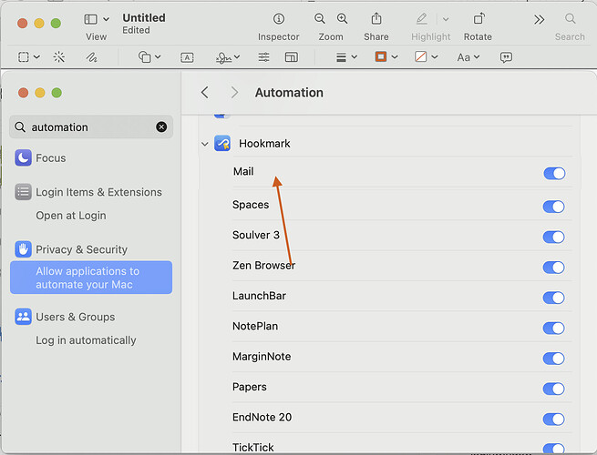

(3) Please open System Settings, type “automation” in search field, select “Allow applications to automate your Mac”, and check if the switch is on for Mail. If it is on, switch it off and on again. See if it resolves the issue.

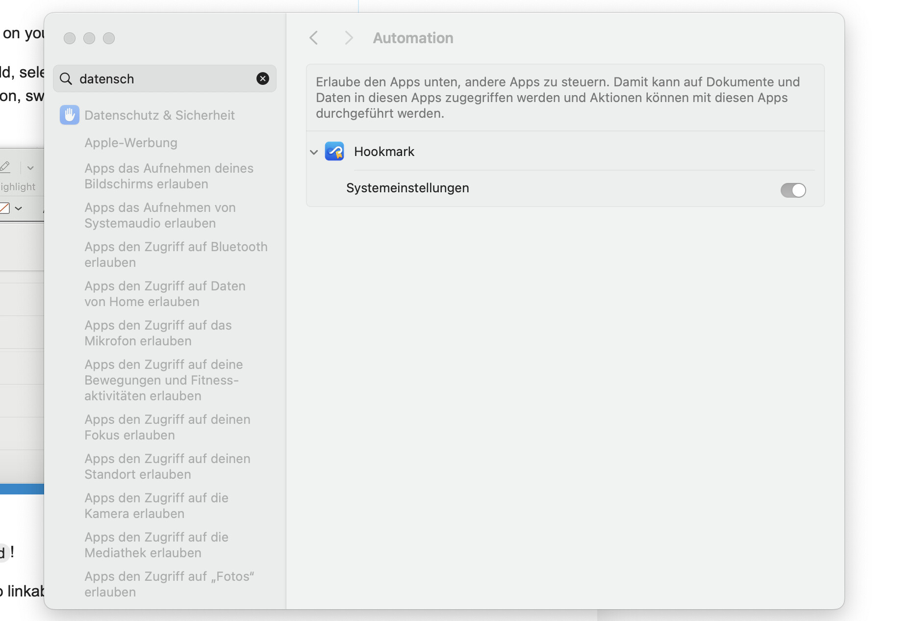

(3) This is interesting: I seem to have Hookmark enabled under automation, but there doesn’t seem to be an option to add specific applications to it … (see screenshot)

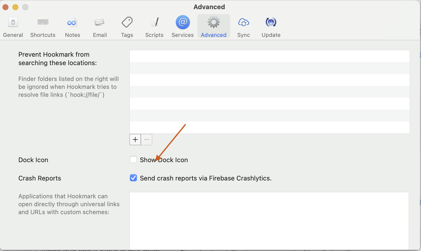

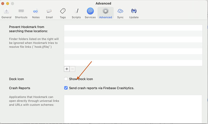

Is your Hookmark in foreground mode? If yes, could you please switch it to background mode and see if there is any difference? To run Hookmark in the background, open the Hookmark Settings window, go to the ‘Advanced’ tab, and turn off the ‘Show Dock icon’ option.
Thanks again, @bchend. I am happy to report that completely deleting Hookmark and then installing it again through SetApp did the trick. I have it set to Foreground mode now. I imported my saved bookmarks back into Hookmark and they’re all there.
