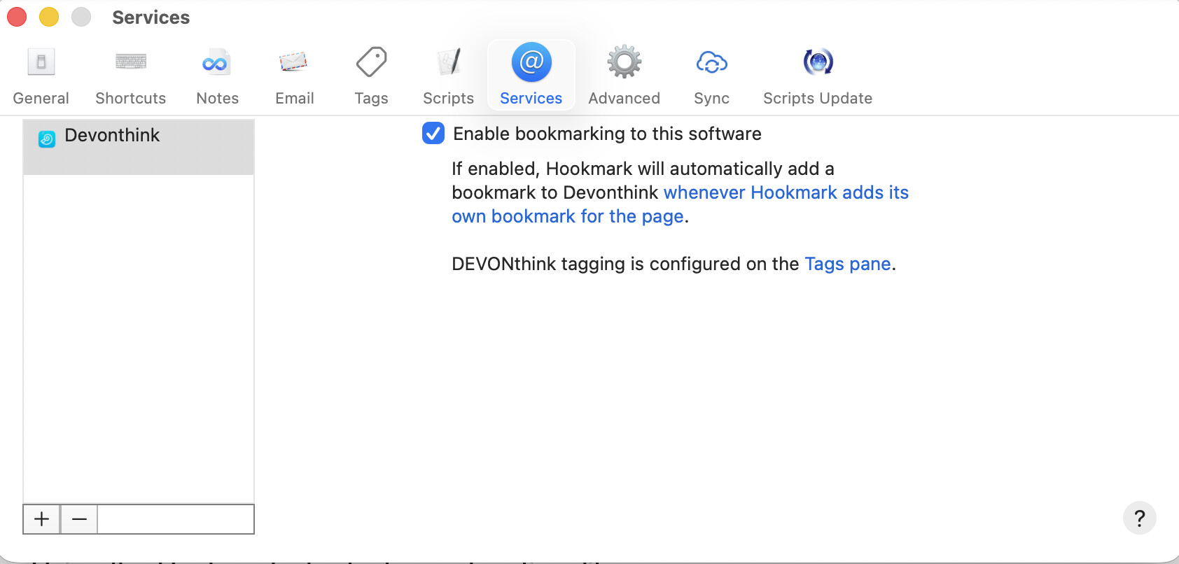

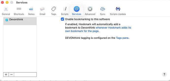

Just in case anybody else is having the same problem… @bchend from support kindly gave me the solution. It was user error, as I half suspected…
As well as following the instructions in the release notes, you have to add DEVONthink as a service and enable it in the Services panel:
I’d never used the tags or services features before and didn’t realise this needed to be done… Once I had, the bookmarks are created properly in DEVONthink as expected.
