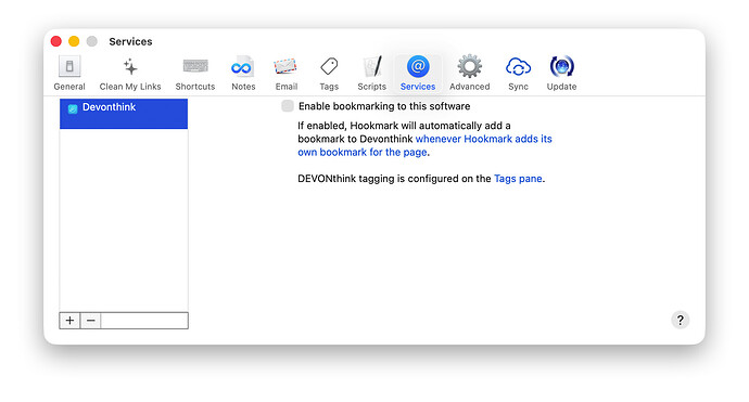

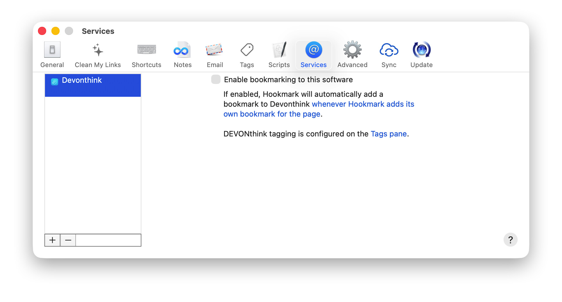

Fixed the problem now:
the problem arose with any “hook to new …” command as long as the option “Enable bookmarking to this software” was active for Devonthink (under services).
Now I deactivated this option and Hookmark works seamlessly again as expected.
Hope this helps debugging the problem.
