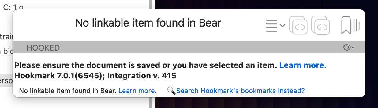

Hello! I’m having the exact same problem as @shiveenp, just almost 2 years later :laughing:
If I type ⌥ + ⇧ + ⌘ + L with a Bear note selected, it does indeed give me the callback URL. I can then add this manually as a bookmark in Hookmark, but defeats the point a bit :rofl:
But if I try it by invoking Hookmark (⌘ + H) – I get the ‘No linkable item’ message.
Thank you for reporting this issue, @mwhitexie .
Could you please update your Hookmark script and see if the issue is fixed? (Hookmark preference window->Update->Check now)
