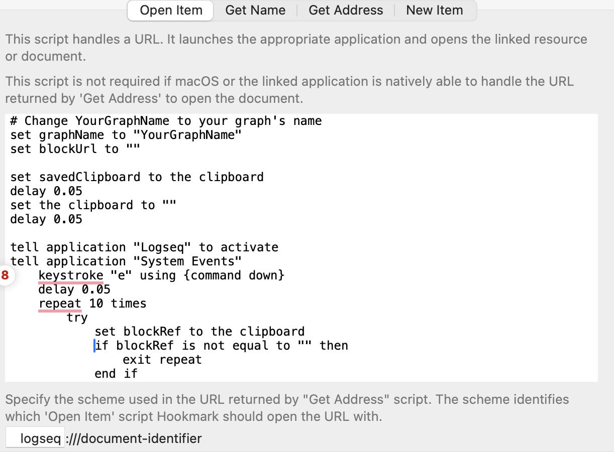

Hi,
I am trying to integrate Logseq with Hookmark, and I used the script as in the image below.
On the Logseq side, I modified the config.edn as follows (I added the last three rows):
 ;; :shortcuts
 ;; {:editor/new-block       "enter"
 ;;  :editor/new-line        "shift+enter"
 ;;  :editor/insert-link     "mod+shift+k"
 ;;  :editor/highlight       false
 ;;  :ui/toggle-settings     "t s"
 ;;  :editor/up              ["ctrl+k" "up"]
 ;;  :editor/down            ["ctrl+j" "down"]
 ;;  :editor/left            ["ctrl+h" "left"]
 ;;  :editor/right           ["ctrl+l" "right"]}
    :shortcuts {
      :editor/copy-embed "mod+shift+c"
However, from Logseq, by pressing Command+Shift+H, I see “No linkable item found in Logseq”.
What was wrong?
Is there anything I miss?
Welcome to Hookmark forum, @nicfab .
Is there any error message in Hookmark window? Could you please post the screenshot of Hookmark window?
@bchend Thank you for your reply.
I found a solution just now.
Now it works fine.
Great job figuring that out on your own!
