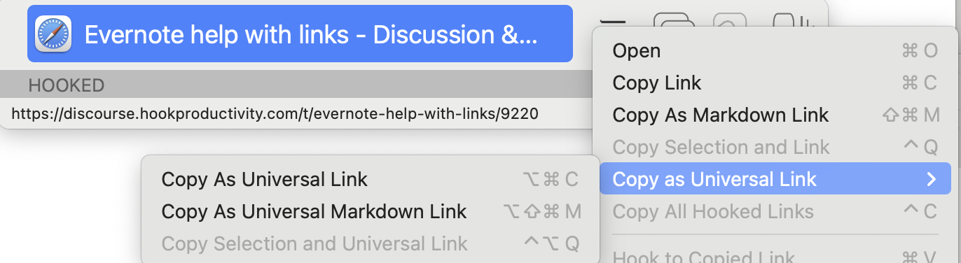

For non-https URL, please do Hookmark “Copy as Universal Link”, then paste the link in Evernote. Please give it a try.

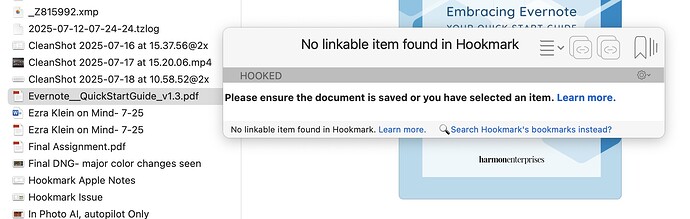

Does Hookmark work with other APPs?

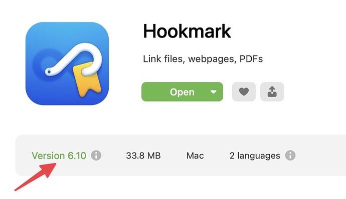

Are you using Hookmark 6.10? If not, please update to 6.10. Then post a screenshot of Hookmark window with “No Linkable item…” error message.
Yes, using 6.10.
Thank you, @epetrack .

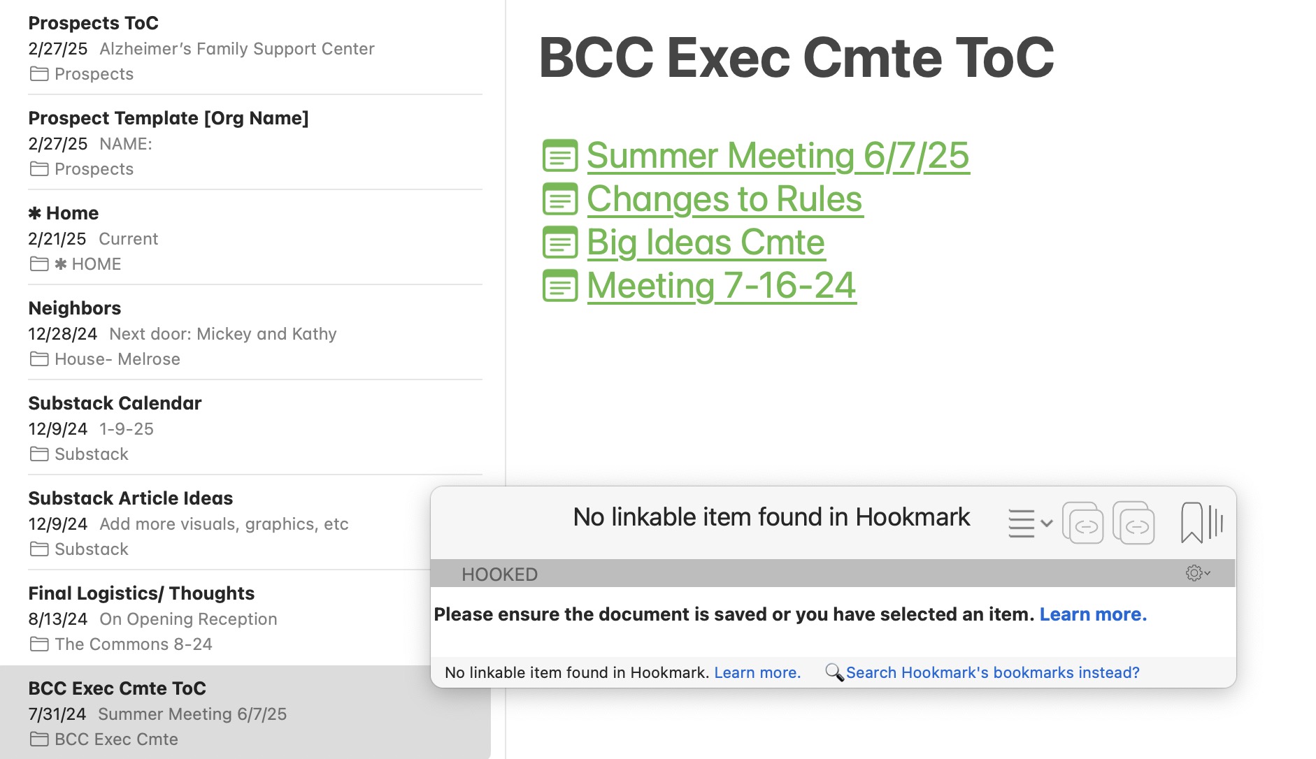

Could you post a screenshot of Hookmark window for an Apple Note?
Also, could you go to Hookmark Settings window ->Scripts->Finder->Get Address, replace the script with the following script, and click on save button. Then invoke Hookmark on a selected file in Finder, post all the output here.

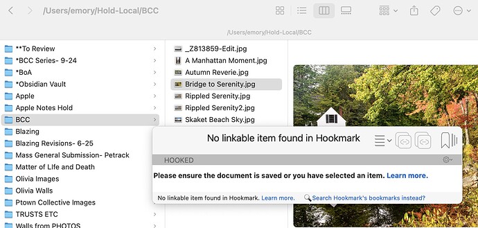

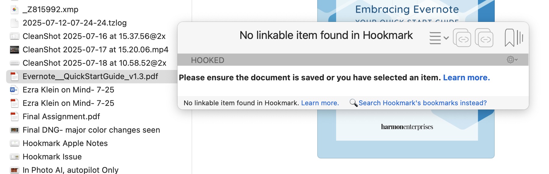

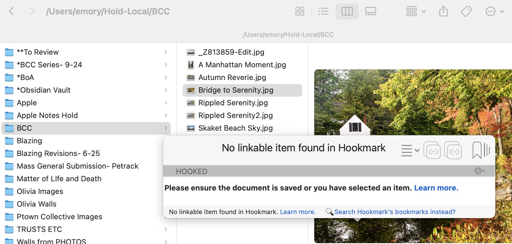

Here you go- thanks-
Thank you for the screenshots, @epetrack .
How did you invoke Hookmark window? It seems Hookmark is in foreground. Sorry I missed that.
If you use Ctrl+H or Shift+command+space(Depends on your Shortcuts setting in Hookmark Settings window), what do you get?

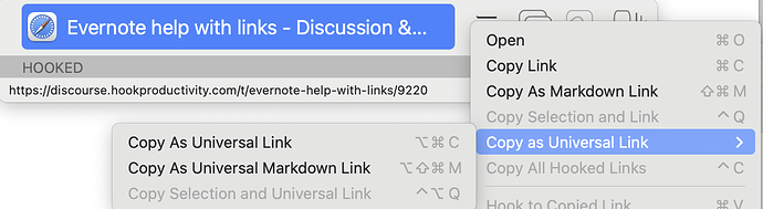

ok- major progress now! I was just opening hookmark (invoked using Alfred)… Using Ctrl+H works (and then CMD-C to copy link)… thanks. Now circling back to Evernote issue. I now see that if I use Ctrl-H, then opt-cmd-C to copy universal link, that DOES work in Evernote (for both files, Apple Notes, and even Spark)- that’s great!
I think I saw this request before in the forum, but is there a way to not have to go thru those 2 separate keyboard shortcuts to get the universal link?!

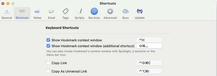

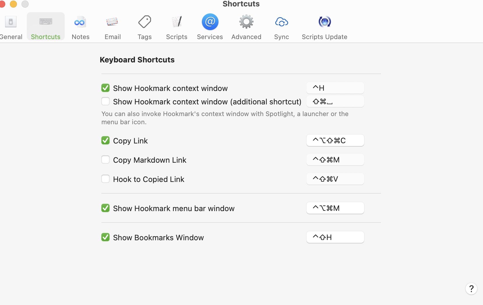

Yes, you can configure in Hookmark settings window->Shortcuts. First, you need enable “Copy As Universal Link” check box. Then type in the shortcut. Please make sure this global shortcut is not used by other APPs.

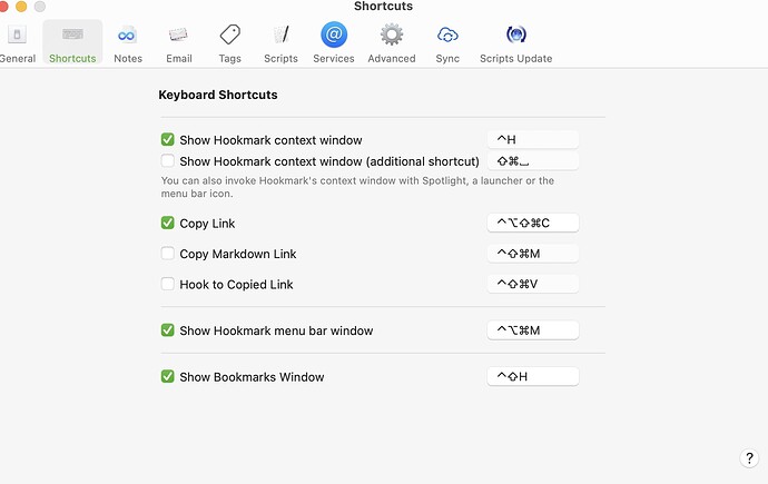

Thanks- This is strange, but my Keyboard Shorcuts prefs look different, not showing Copy as Universal Link (see image)- what am I missing?!

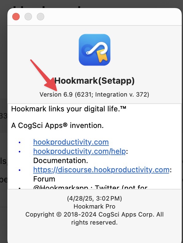

Post your Hookmark about window please.

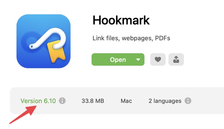

My bad… was troubleshooting on other mac, which had 6.9 installed. But… Setapp shows 6.10 installed, while “about” on the Hookmark app shows 6.9! I tried quitting/ restarting them, but not changing… (this is on MB Air; all fine now on MB Pro)
NEVER MIND- Just tried again quitting both setapp and hookmark, and it now did update to 6.10… THANKS for all your help!
