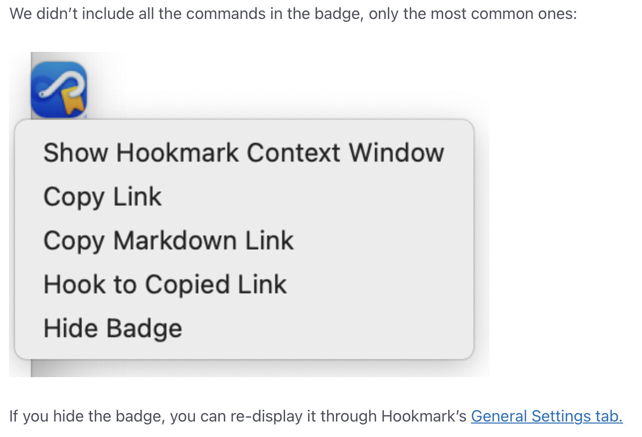

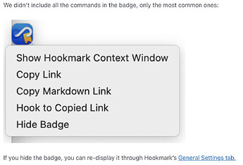

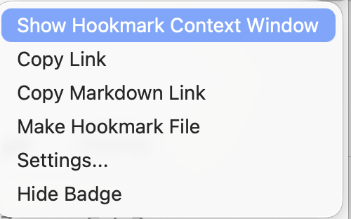

The icon/pop up menu is great but needs a few more choices on the list to be more valuable. Hook has grown. It wouldn’t hurt my flow to press the up or down key a couple of times if necessary to select. Or use the shortcuts from the context window.

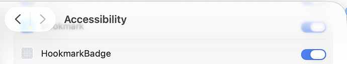

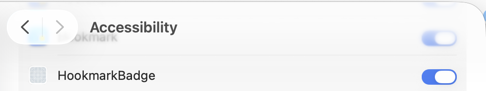

Also,should there be a hookmark and a badge app permissions?
Only entry for Hookmark@2x
Just want to confirm, have you grant Hookmark badge accesibility via System Settings → Privacy & Security ->Accesibility?
Also what’s your Hookmark version?
@bchend,
| bchend Hook support email
May 2 |
Yes, I have granted accessibility. However ,I have only the badge as shown in my first mail.
Wasn’t labled badge, I assumed it was an upgraded icon.

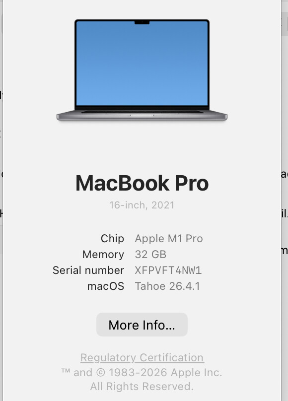

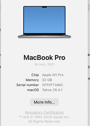

Also what’s your Hookmark version? Hookmark Version. 7.1 (6582; Integration v. 416) MacOS 26.4.1 (25E253)

Thank you, @bnm3215 .
Can you see Settings.. menu item in Hookmark badge menu?
If no, please remove all old Hookmark on your Mac and restart Hookmark and see if it helps.
